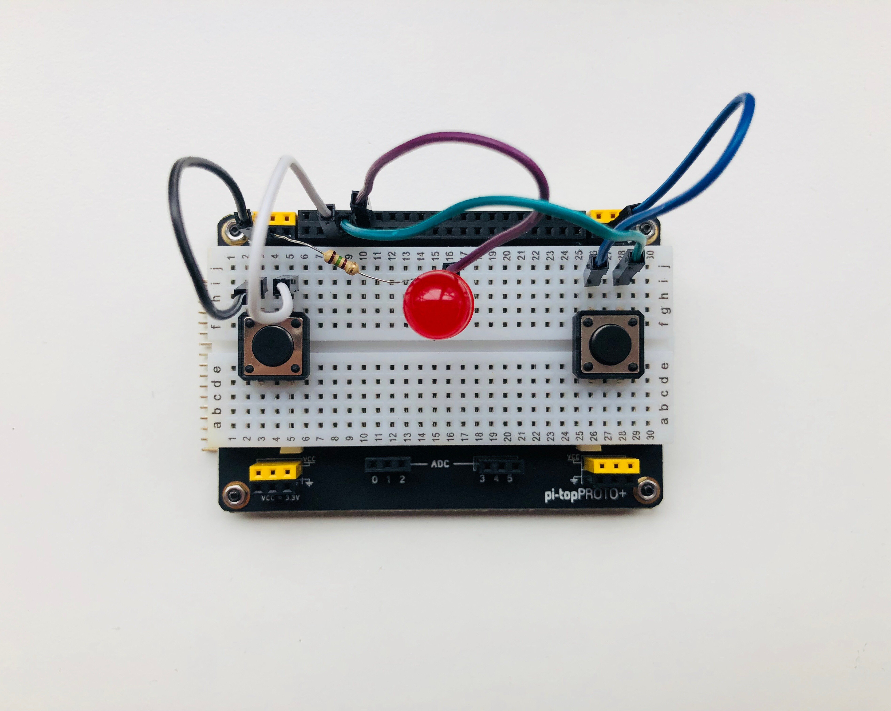

Building the Circuit
IMG_2923
The first thing you’ll need to do to is to build your circuit. You’re going to need one LED and resistor, two buttons and, depending on whether you’re using a pi-topPROTO or pi-topPROTO+ board 5 m/f and a bread board or just 5 m/m jumper cables.
We connected the LED to pin 15 and the two buttons to pins 3 and 4 and then had to use the special GPIO extension blocks in order to set up the pins as either inputs or outputs.

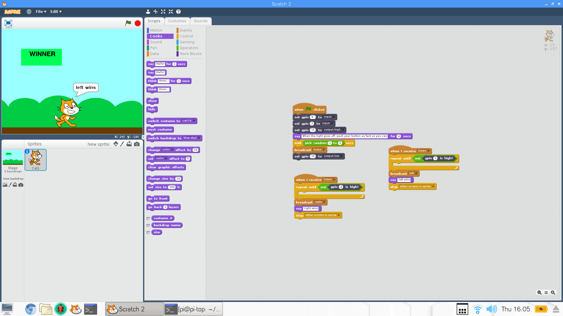

Writing the Code
Scratch_03_05_2018
Our code was pretty simple. We used broadcast blocks to ensure that the buttons weren’t ‘live’ until the LED turned off. The hardest part was figuring out how to make sure that the code looked for just the first button push and that one was declared the winner. We were able to use a ‘repeat until’ block combined with ‘not gpio 3 high’ to detect when the button was pushed. We finished up with ‘stop other scripts in sprite’ to ensure the winning button push ended the game.
Finally, we added a few fun touches like some ‘say’ messages and a change of background depending on who the winner is.
